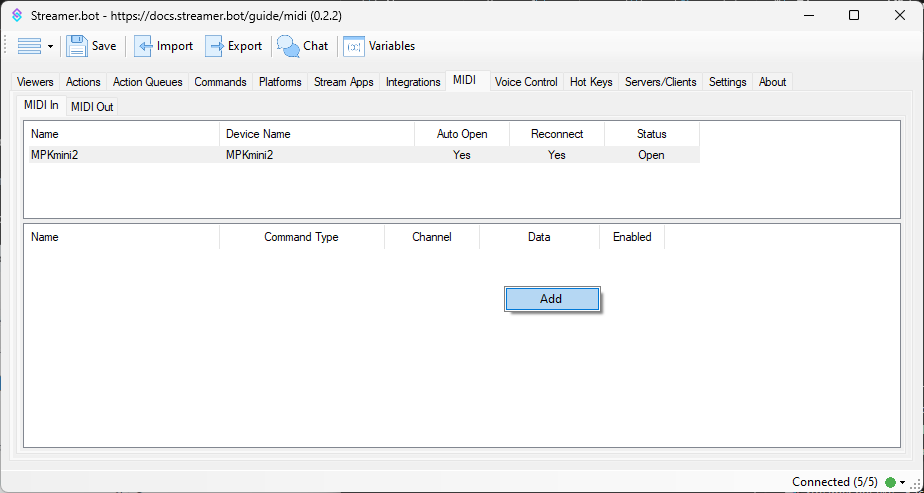

In Streamer.bot, navigate to the MIDI tab
MIDI In and MIDI Out devices are stored separately, so be sure to navigate to the appropriate tab for the type of interactions you would like to make. You can also add the same device in both tabs.

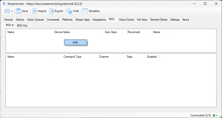

To add a new device, Right-Click anywhere in the device pane and select Add

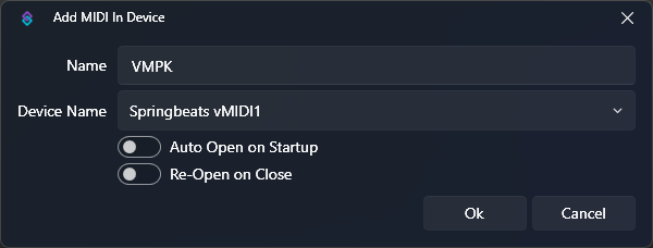

This will open the add device dialog with the following configuration options:
Enter a descriptive name for this device connection
Device
Select your device from a list of currently connected MIDI devices
Auto Open on Startup
Automatically connect to this device when Streamer.bot starts up?
Reopen on Close
Automatically reconnect to this device when the connection is closed?
Retry Interval
When Reopen on Close is enabled, retry the connection at the entered interval, in seconds

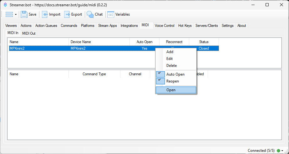

Right-Click any existing device to reveal the context menu options:
Add
Add a new MIDI device, opening the configuration dialog outlined above
Edit
Edit the selected MIDI device, opening the configuration dialog outlined above
Delete
Delete the selected MIDI device connection
Auto Open
Quickly toggle the Auto Open on Startup configuration option for this device
Reopen
Quickly toggle the Reopen on Close configuration option for this device
Open
Manually open the connection to this device
Once you have created a MIDI In device, you can select it to register your incoming event listeners in the bottom pane.
Make sure the device is currently connected. You can manually Right-Click the device and select Open
With your device selected in the top pane, you can Right-Click on bottom pane and select Add to create a new event listener.

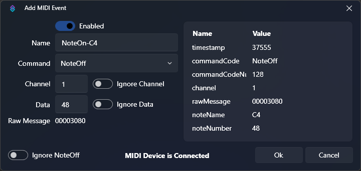

You should now see the Add MIDI Event dialog:
MIDI Event Dialog
You can now automatically generate the event configuration by triggering an event from your MIDI device
  • Press a key
  • Press a pad
  • Turn a dial, knob, or wheel
  • Press any button which sends a MIDI message
Enable or disable this event listener
Enter a descriptive name for this event listener
Automatic detection is supported
Command
Select the MIDI event type you would like to listen to
Channel
Number required
Enter the MIDI channel to listen on
Ignore Channel
Listen on any channel
Data
Number required
Enter the MIDI data value to listen for
Ignore Data
Listen on any data value
This can be useful if you would like to trigger an action on any key value
Raw Message
ReadOnly
Displays the raw MIDI message value
Ignore NoteOff
Ignore NoteOff events
Some keyboards will send both NoteOn and NoteOff events. This option allows you to automatically generate event configuration for NoteOn without it being overridden by the following NoteOff event
