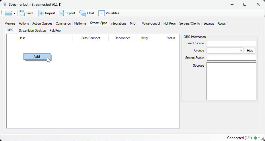

Navigate to Stream Apps > OBS in Streamer.bot
OBS Studio Configuration
To add a new connection, Right-Click anyhere in the panel area and select Add:

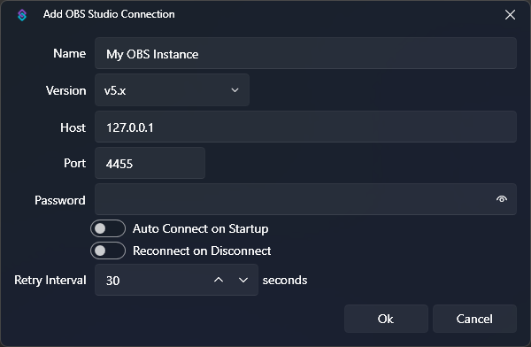

Configuration options are outlined below:
Enter any name or label to describe this OBS instance, e.g. Local OBS
Version
Select the version of OBS WebSocket to use for this connection.
As of OBS Studio v28.0.0, OBS WebSocket v5 is included by default.
  • To continue using OBS WebSocket v4.9+, you must install the obs-websocket-4.9.1-compat plugin
  • It is recommended to update to if you are currently using an older version.
Host
Enter the host address of your OBS WebSocket ServerIf OBS Studio is running on the same machine as Streamer.bot, keep 127.0.0.1For multi-pc setups you can configure this with another LAN IP address, e.g. 192.168.1.10
Port
Number required
Enter the port of your OBS WebSocket Server
  • Default: 4455 (v5+) or 4444 (v4.9+)
    It is recommended to keep the defaults unless you are using multiple OBS portable installs on the same desktop.
Password
If you configured authentication in OBS, enter the password for your OBS WebSocket Server
Auto Connect on Startup
Automatically connect to this OBS Studio instance when Streamer.bot starts up
Reconnect on Disconnect
Automatically reconnect to this OBS Studio instance when the connection is disrupted
Retry Interval
Change the interval of reconnection attempts when Reconnect on Disconnect is enabled
Right-Click on a configured connection to reveal the context menu:
Add a new OBS Studio connection
Edit the selected OBS Studio connection
Delete the selected OBS Studio connection
Quickly toggle the Auto Connect on Startup configuration option for the selected connection
Quickly toggle the Reconnect on Disconnect configuration option for the selected connection
Set this connection as the default when importing actions
If no default is set, imported actions will default to the first connection in the list
Temporarily override all OBS Studio connections to use the selected connection.
This setting does not persist when you restart Streamer.bot
Reconfigure all actions utilizing an OBS Studio connection to use the selected connection
Manually attempt to connect to the selected connection
