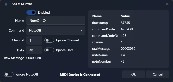

You should now see the Add MIDI Event dialog:
MIDI Event Dialog
You can now automatically generate the event configuration by triggering an event from your MIDI device
  • Press a key
  • Press a pad
  • Turn a dial, knob, or wheel
  • Press any button which sends a MIDI message
Enable or disable this event listener
Enter a descriptive name for this event listener
Automatic detection is supported
Command
Select the MIDI event type you would like to listen to
Channel
Number required
Enter the MIDI channel to listen on
Ignore Channel
Listen on any channel
Data
Number required
Enter the MIDI data value to listen for
Ignore Data
Listen on any data value
This can be useful if you would like to trigger an action on any key value
Raw Message
ReadOnly
Displays the raw MIDI message value
Ignore NoteOff
Ignore NoteOff events
Some keyboards will send both NoteOn and NoteOff events. This option allows you to automatically generate event configuration for NoteOn without it being overridden by the following NoteOff event
