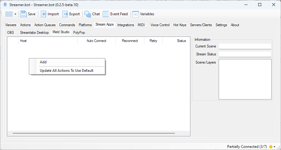

Navigate to Stream Apps > Meld Studio in Streamer.bot
Meld Studio Configuration
To add a new connection, Right-Click anyhere in the panel area and select Add:

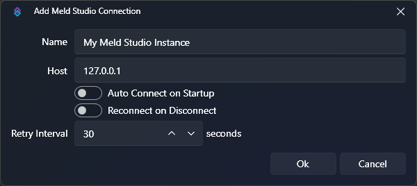

Meld Studio Connection Dialog
Configuration options are outlined below:
Enter any name or label to describe this Meld Studio instance, e.g. Local Meld Studio
Host
Enter the host address of your PCIf Meld Studio is running on the same machine as Streamer.bot, keep 127.0.0.1For multi-pc setups you can configure this with another LAN IP address, e.g. 192.168.1.10
Auto Connect on Startup
Automatically connect to this Meld Studio instance when Streamer.bot starts up
Reconnect on Disconnect
Automatically reconnect to this Meld Studio instance when the connection is disrupted
Retry Interval
Change the interval of reconnection attempts when Reconnect on Disconnect is enabled

Status Panel
Selecting a connected Meld instance in the left panel will reveal additional realtime information about that instance on the right panel.
Current Scene
Shows the name of the currently broadcasting scene on the selected connection
Stream Status
Shows the status of the current streaming and recording activity
Scenes/Layers
List
Lists all layers present on the currently selected scene
