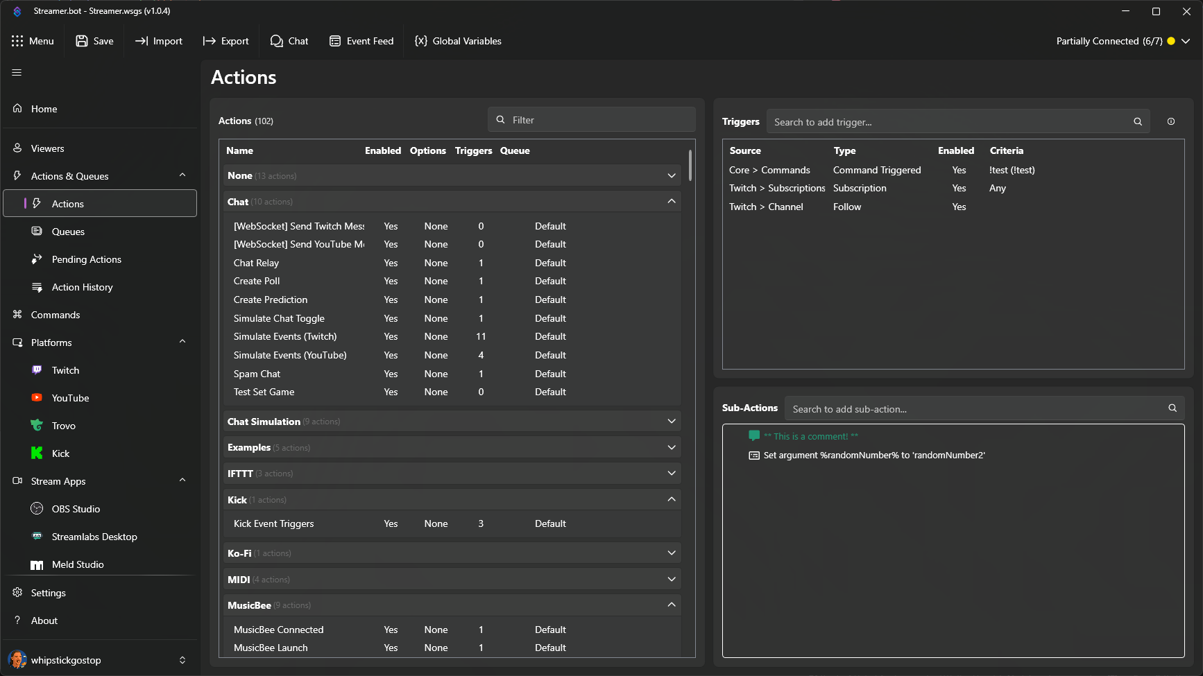

To get started, navigate to Actions & Queues > Actions in Streamer.bot
Streamer.bot Actions View
The actions view is split into 3 main parts:
  1. Actions - All of your configured actions are listed here, sorted by group
  2. Triggers - All triggers configured for the selected action will be listed here
  3. Sub-Actions - All sub-actions configured for the selected action will be listed here

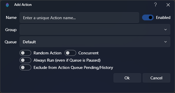

To create your first action, Right-Click in the actions pane and select Add to open the configuration dialog
Add Action Dialog
Options
The friendly name the action will be referred as throughout the bot
Group
Optionally type or select a group name.
This can be used used to organize similar actions into collapsible sections to keep the interface clean if you have a large number of actions
Queue
Assign this action to an Action Queue
The Default queue is configured as a non-blocking queue, meaning actions will execute immediately on request and are allowed to run concurrently.
Learn more about Action Queues below
Toggle this action on or off
Random Action (RA)
Randomly execute a single sub-action from within this action
Sub-action groups will be treated as a single entity and will execute as if they were a standalone action.
This option enables the Weight configuration on sub-actions, allowing you to adjust the probability that specific sub-actions will be chosen.
Concurrent (CC)
Execute all sub-actions in this action simultaneously, rather than waiting for each step to complete.
This will also ignore the Delay sub-action
Always Run
Force this action to execute even if the queue is in a Paused state
Exclude from Action Queue Pending/History
Exclude this action from being logged to the action history.
This option is recommended for frequently executed actions to improve performance of your bot

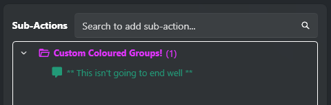

Add Group
Action
Create a sub-action group
If the action contains any groups the Move to Group sub menu will also display below this option

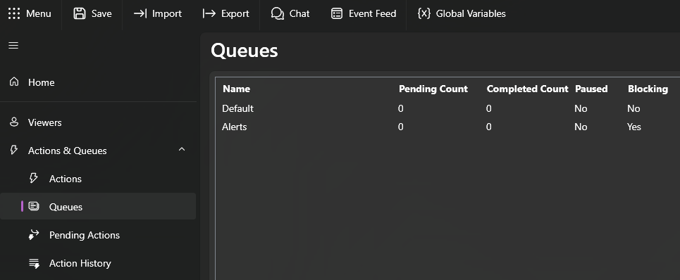

Action Queues
In Streamer.bot, all actions exist within a queue. The Default queue is created automatically and will contain all action executions unless specified otherwise.
Queues
To get started, navigate to Actions & Queues > Queues in Streamer.bot
Queues List View
In this section, you will find all the queues that have been created.
At a glance, you can view the status of several queue properties:
  • Pending Count: Number of actions waiting to be executed within the respective queue
  • Completed Count: Number of actions that have completed execution within the respective queue
    • This includes actions that have been cancelled - learn more in Action History
  • Paused: Shows the current paused status of this queue
  • Blocking: Shows whether the queue is configured as a Blocking queue

Enter a descriptive name for your new queue
Blocking
By default, all queues execute actions immediately, with no wait.
To execute actions in sequence, waiting for each previous action to complete, you can enable the Blocking option.
It's especially useful to have a blocking queue for alerts, to allow them to execute one at a time!

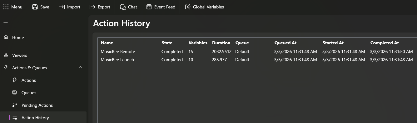

Action History
The action history view will display a log of all actions that have been executed by Streamer.bot
Action History is the best place to discover what variables are available within your action!
Action Queues > Action History View
At a glance, you can view the following properties:
  • Name: The name of the executed action
  • State: The current status of the executed action
    • e.g. Completed, Cancelled, Pending
  • Variables: The number of variables populated by this action
  • Duration: Time, in milliseconds, the action took to finish execution
  • Queue: The name of the queue this action was executed in
  • Queued At: The date and time the action was initially queued for execution
  • Started At: The date and time the action began execution
  • Completed At: The date and time the action finished execution

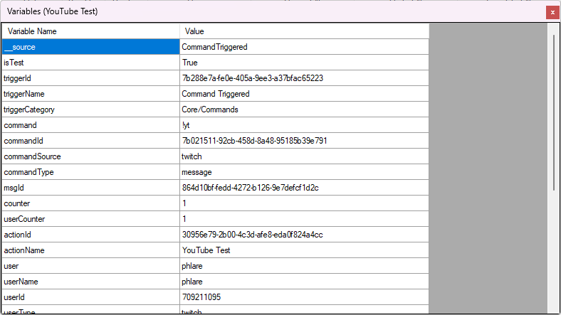

Context Menu
You can Right-Click on any entry to open the context menu:
Inspect Variables When Queued
Dialog
Open a dialog which shows all variables, and their values, available to the action when it was initially queued
Inspect Variables After Run
Dialog
Open a dialog which shows all variables, and their values, available at the end of action execution
