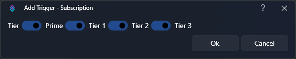

Checkbox configuration can be used to filter incoming triggers based on multiple event types, which can be toggled on or off.
Checkbox Trigger Configuration
For example, the Twitch Subscription Trigger allows you to toggle incoming trigger events for each subscription tier.

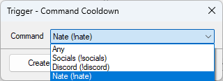

Dropdown configuration can be used to filter incoming triggers based on preexisting values.
Dropdown Trigger Configuration
For example, the Command Cooldown Trigger allows you to filter incoming trigger events for specific commands.
These triggers also include the option Any, which allows events to trigger on any of the included options.

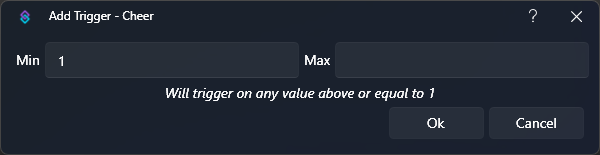

Range
Range configuration is used for filtering incoming numeric triggers based on minimum and maximum values.
Range Trigger Configuration
For example, the Twitch Cheer Trigger allows you to filter incoming trigger events for a specified bit range.
Min and Max values are inclusive
If only a Max is set, the trigger will execute on exact values matching the configured Max
Leave both Min and Max blank to trigger on all values.

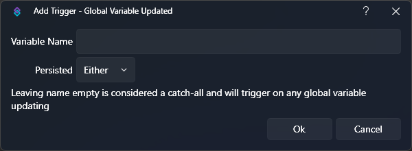

Text field configuration can be used to filter incoming triggers based on arbitrary text values.
Text Box Trigger Configuration
For example, the Global Variable Updated Trigger allows you to filter incoming trigger events based on a specified variable name.
This field can be left empty to trigger on all values.

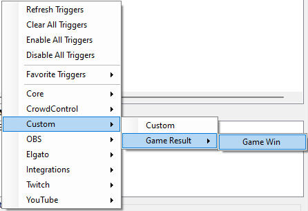

Custom Triggers
Custom Triggers require C# Code to register and execute
You can define your own triggers using C# Code. These will then show up in the trigger menu UI under Custom once the C# code defining them has been run once.
Since custom triggers need to be re-defined on every boot of StreamerBot, it is encouraged to define these in your C# module's public void Init() method and enable Precompile on Application start.
custom-triggers
// Register a new trigger labeled "Game Win" in the "Game Result" category
//                           Label         Name                 Category
CPH.RegisterCustomTrigger("Game Win", "gameResultWin", new[]{"Game Result"});
The category parameter of the RegisterCustomTrigger function always has to be an array, allowing to nest sub-categories.
This is only for user convenience and does not change the process of triggering a custom trigger by name.

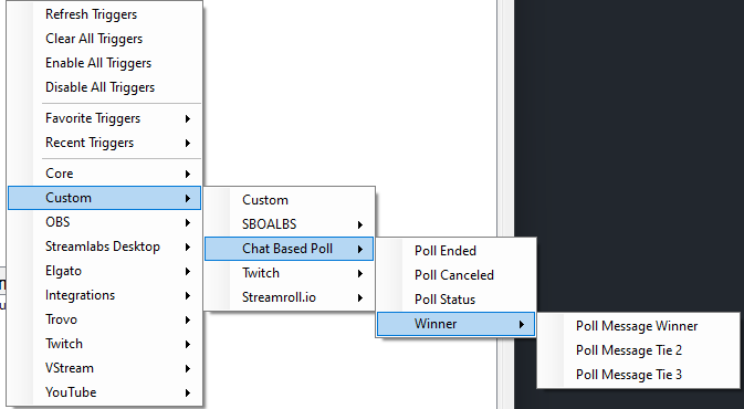

custom-triggers-nested
// Register three top level triggers in category `Chat Based Poll`
CPH.RegisterCustomTrigger("Poll Ended", "poll_ended", new[] {"Chat Based Poll"});
CPH.RegisterCustomTrigger("Poll Canceled", "poll_canceled", new[] {"Chat Based Poll"});
CPH.RegisterCustomTrigger("Poll Status", "poll_status", new[] {"Chat Based Poll"});
// Register three nested triggers in category `Winner`, which is in category `Chat Based Poll`
CPH.RegisterCustomTrigger("Poll Message Winner", "poll_winner_one", new[] {"Chat Based Poll", "Winner"});
CPH.RegisterCustomTrigger("Poll Message Tie 2", "poll_winner_two", new[] {"Chat Based Poll", "Winner"});
CPH.RegisterCustomTrigger("Poll Message Tie 3", "poll_winner_three", new[] {"Chat Based Poll", "Winner"});
