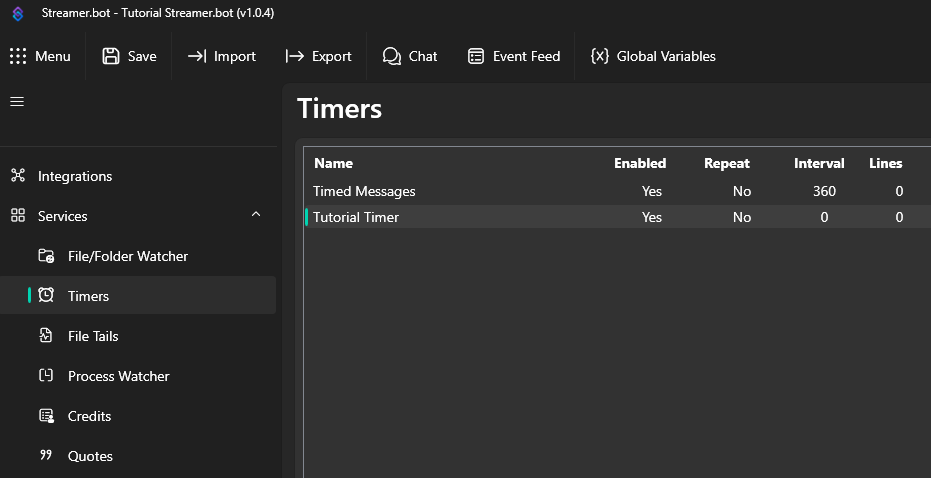

In Streamer.bot, navigate to Services > Timers
To create a new timer, Right-Click anywhere in the list pane and select Add from the context menu.
Timers Navigation

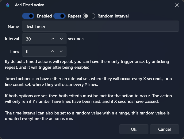

You can now specify the settings of your Timed Action:
Timer Settings
If checked, the Timer is enabled. It will not trigger any action if it's disabled. The countdown and line count only start once it's been enabled.
Repeat
If checked, the Timer will run again after it has fired. If unchecked, the Timer will just run once and disable itself afterwards.
The name of your Timer. It has no direct impact and it just for your own organisation.
Interval
The time, in seconds, that has to pass for the Timer to trigger.
Random
If checked, you can specify an interval for the interval. So the Timer fires randomly between x and y seconds.
Lines
If lines is greater than 0, then x many chat messages need to be posted before the Timed Action fires. If the Interval is set to 30 seconds and Lines to 5, then it will trigger after 30 seconds have passed and 5 different messages have been posted to chat. If one requirement is fulfilled, it will wait for the other requirement.
The Lines requirement does not work if you have multiple streaming platforms connected (like Twitch and YouTube). In that case, leave it at 0.
