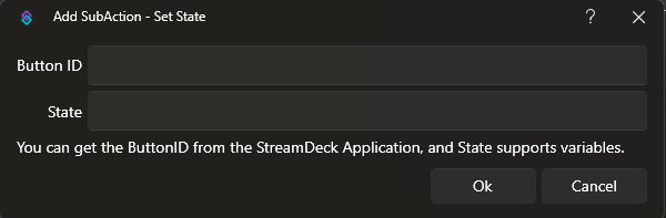

Set State
Modify the active state of a Stream Deck key or dial
Set State Dialog
Button ID
The ID of the Stream Deck button or dial to modify.
If you give multiple buttons the same ID, all will be modified simultaneously
You can utilize %variable% syntax to dynamically modify buttons with argument values
ElgatoStreamDeckButtonState
0
Optionally select a specific button state to modify
For example, to modify the 2nd state of an Action Switch, set State to 1
public void StreamDeckSetState(string buttonId, int state)
