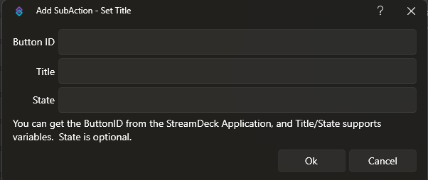

Set Title
Modify the title of a Stream Deck key or dial
Set Title Dialog
Button ID
The ID of the Stream Deck button or dial to modify.
If you give multiple buttons the same ID, all will be modified simultaneously
You can utilize %variable% syntax to dynamically modify buttons with argument values
Title
The new value to use as the button title
0
Optionally select a specific button state to modify
For example, to modify the 2nd state of an Action Switch, set State to 1
