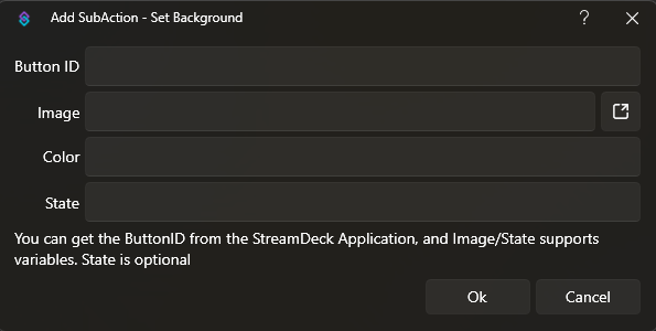

Modify the background image of a Stream Deck key or dial
Set Background Dialog
Button ID
The ID of the Stream Deck button or dial to modify.
If you give multiple buttons the same ID, all will be modified simultaneously
You can utilize %variable% syntax to dynamically modify buttons with argument values
Image path or data used to update the background image of a Stream Deck button
Supports any of the formats shown below:
Color
Set the background color of the given button.
When color is configured in addition to the image field, the image will be placed on top of the selected background color.
0
Optionally select a specific button state to modify
For example, to modify the 2nd state of an Action Switch, set State to 1
