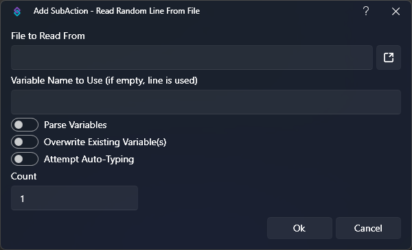

Read Random Lines From File
Load the contents of a file and populate a set of variables from random lines
Read Random Lines From File Dialog
File to read from
File required
Select the file to load, or enter a path
Variable Name
line
Enter a variable name to override the default randomLine# variables with your own naming scheme
Parse Variables
false
Enable this option to enable parsing and replacement of %variables% found within the file contents
Attempt auto-typing
false
While reading the contents of the file, attempt to auto-type on a line-by-line basis.
For example, if a line consists a number, the resulting variable for that line can be properly typed as an int
Count
1
Number of random lines to extract from the file
True or False if the file is present on disk
Example Value:Hello, world!
Each random line extracted based on the Count you configured. The line counter suffix is omitted from the first line read.
e.g. %randomLine%, %randomLine1%, %randomLine2%, and so on...
Example Value:3
The line number (numbered from 0) of each random line read. The line counter suffix is omitted from the first line number.
e.g. %randomLineNumber%, %randomLineNumber1%, %randomLineNumber2%, and so on...
