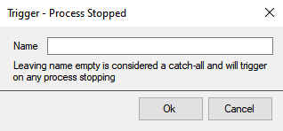

Process Stopped
Trigger for when a Process is Stopped
Process Stopped Trigger Dialog
This trigger relies on the Process Watcher service
You can enable the Process Watcher in Streamer.bot by navigating to
Services -> Process WatcherParameters
The name of the process to watch for. This is the name of the process as it appears in Task Manager.
An empty value is considered a catch-all and will trigger on any process started on your machine.
