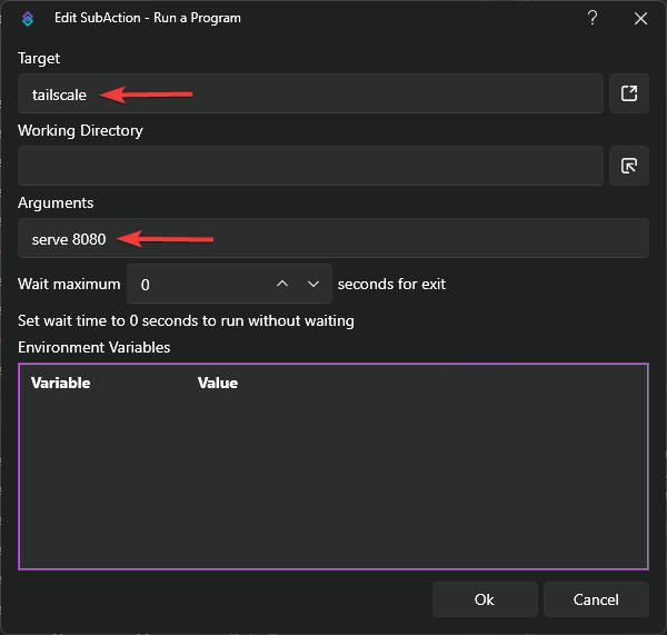

Execute Tailscale Serve via Streamer.bot
Alternatively, we can use the Run a Program sub-action to execute the command directly from Streamer.bot, allowing use of triggers to start Tailscale Serve when certain events happen.
For example, if you add the Streamer.bot Started trigger to your action, Tailscale Serve will automatically start whenever Streamer.bot starts up!
Configure Run a Program sub-action to execute tailscale serve
You should see a command line window open, with the URL to access your Streamer.bot WebSocket server via Tailscale Serve.

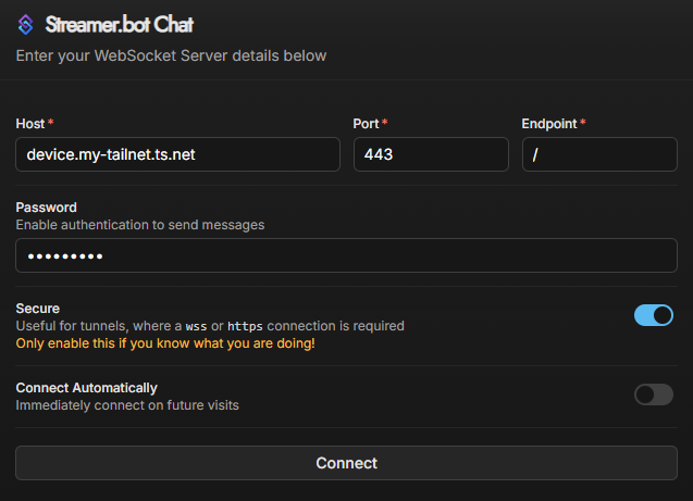

Connect to Streamer.bot
You can now connect to your Streamer.bot instance from any device on your tailnet using the URL provided by Tailscale Serve.
Because Tailscale Serve uses HTTPS, the port you use to connect will always be 443 and you will need to use wss:// scheme.
Examples
const client = new StreamerbotClient({
  host: 'device.my-tailnet.ts.net',
  port: 443,
  scheme: 'wss'
