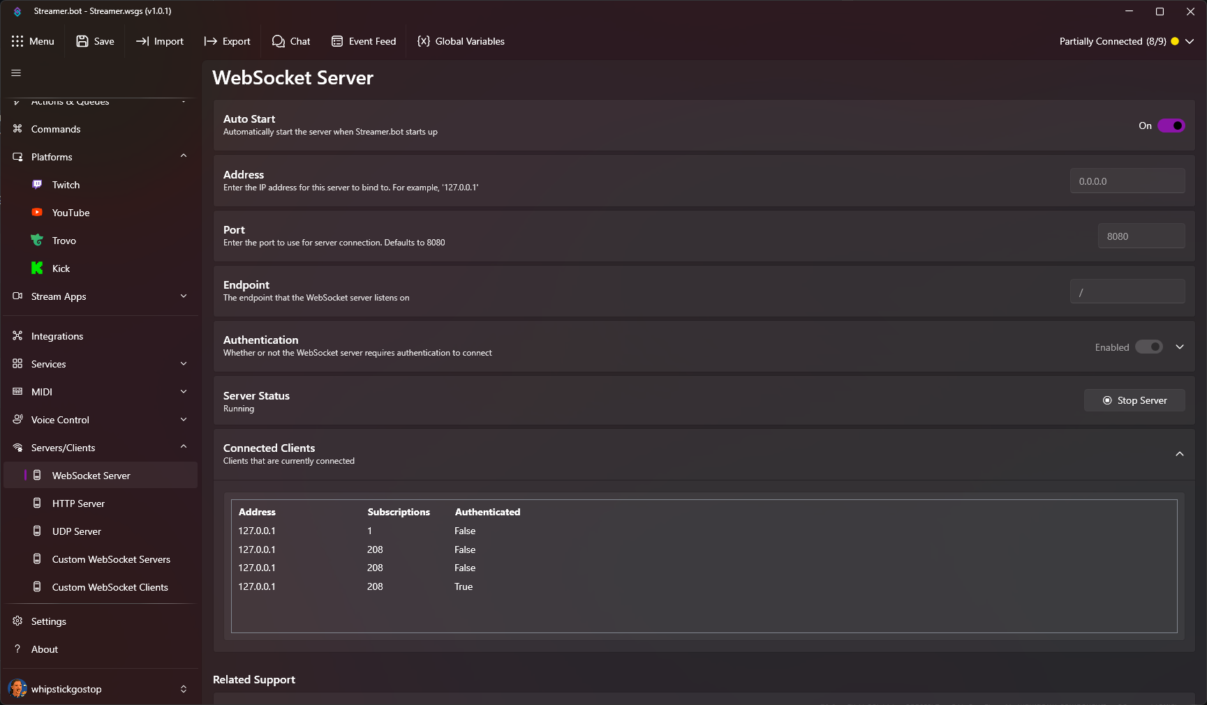

Navigate to Servers/Clients > WebSocket Server in Streamer.bot
WebSocket Server Settings
Options
Auto Start
default:true
Automatically start the WebSocket Server when Streamer.bot starts
Address
default:127.0.0.1
The IP address the WebSocket Server will bind to
You can set this to 0.0.0.0 to bind to all available network interfaces and make the server accessible from other devices on your network.
Port
default:8080
The port the WebSocket Server will listen on
Endpoint
default:/
The endpoint path for the WebSocket Server
Authentication
default:false
Enable authentication for WebSocket clients
By default, authentication is only enforced on priveleged requests, such as SendMessage To enforce authentication for all requests, enable the Enforce option outlined below
Enforce
default:false
Enforce authentication for all requests
If enabled, all clients must authenticate using the Authenticate request
Password
The password required for clients to connect if authentication is enabled
